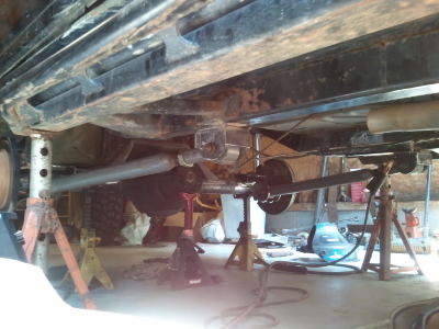

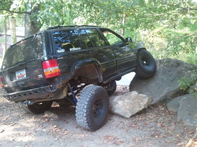

Ya i'm doing a bunch of work on the parents house over break. I ordered the iron rock off road kit that i had talked to you about. Seemed the most complete and simple.
#24
dang ronnie i didnt even noticed the rub bars today those are good lookin sliders. are you gonna long arm the rear anytime soon?

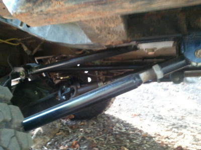

Thanks man. I want to long arm it as soon as I can, short arms work but after watching Caseys and riding in it the stability a 4 link gives is awesome. Got to buy a front axle first and once I get that all paid for in and done Ill start saving for the 4 link. Tube inserts, johnny joints, and dom adds up real quick.

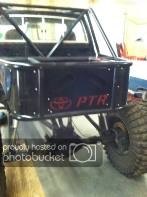

#27

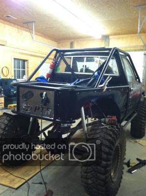

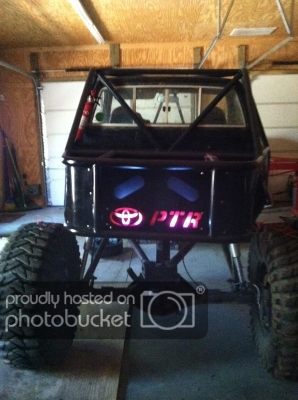

after wheeling the truck for a little over a year now decided to but a tailgate and bedsides on it. The bed sides are made from rolled plastic from summit racing. oval holes in the tailgate will be backup lights and the brake / tail light will be the red Toyota / PTR cut out backlit.

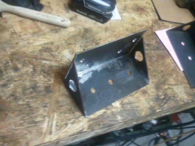

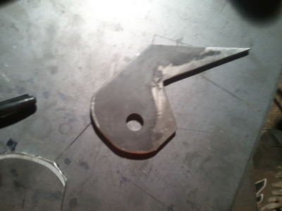

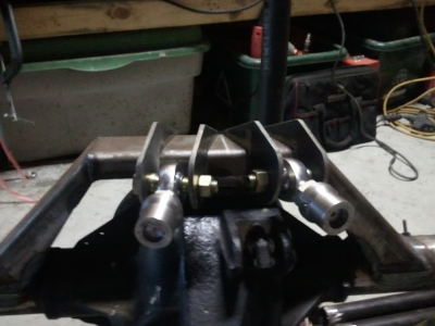

#34

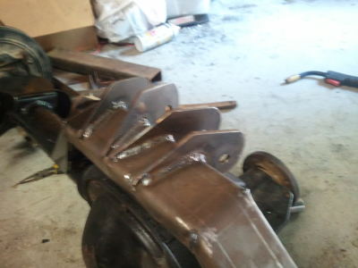

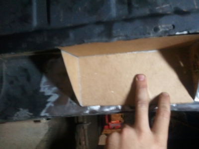

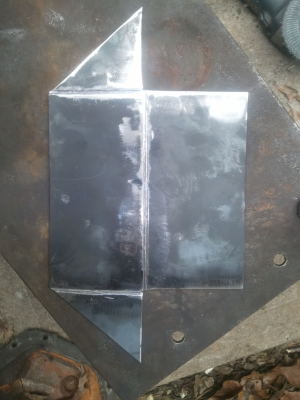

Inner unibody stiffeners
One tab for my uppers on the truss
All 4 cut out
Burned in :weld:
The truss came from ruffstuff and was in two pieces you welded together. It was a "medium" size truss that was generic to fit 1/2 ton axles like 8.8, 44, 9" etc. Ground it down a little and it fit great.
Inner part welded on
Lowers set up
Done

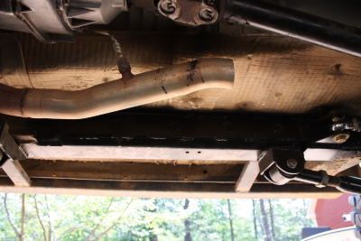

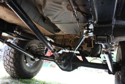

#38
Nice, shaved 14 bolts are sweet.

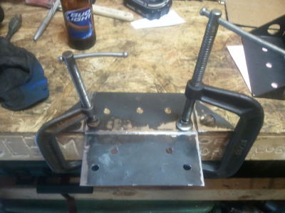

Couple more pics, actually got a decent camera to use.

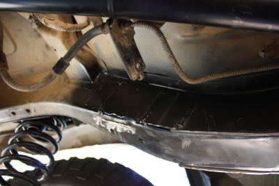

Inner unibody stiffeners welded up

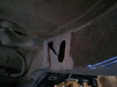

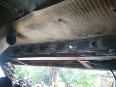

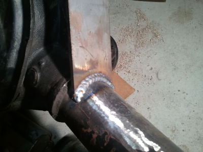

here you can see the cracks in my unibody, other side was worse then this one

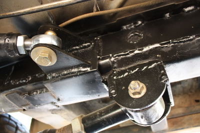

all plated and welded up
Link mounts. Some welds dont look great on the stiffeners, they penetrated but was my first time welding to the unibody so had a little learning curve.
