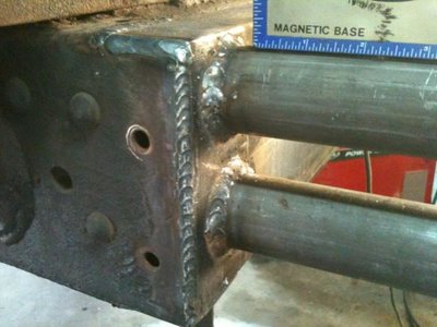

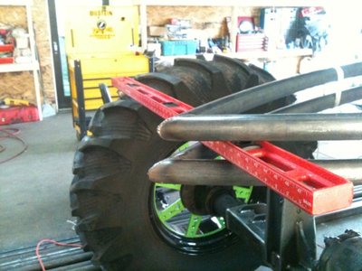

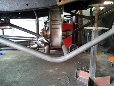

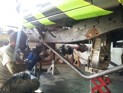

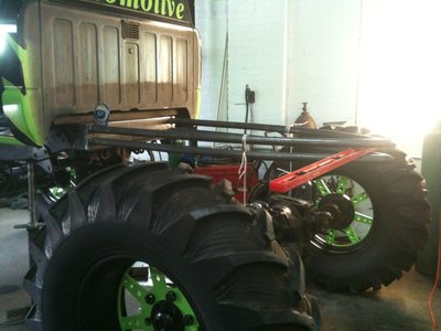

Thanks 72rockcruiser. Sorry for the lack of updates this week. We have been working on it just hadn't posted. Heres some more eye candy for everyone.
We wanted to do something a little different in the back so thats why we decided to run it into a point. We are running two tubes in the rear on top of each other spaced apart and with a slightly different length on each of them so they don't sit dirrectly over each other and more like stacked if that makes sense. You'll see in the pictures

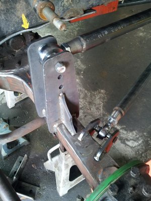

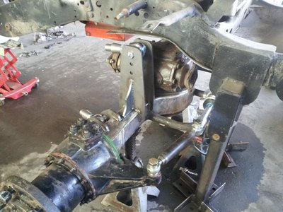

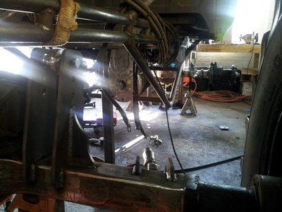

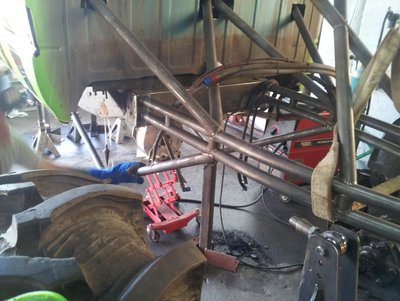

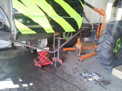

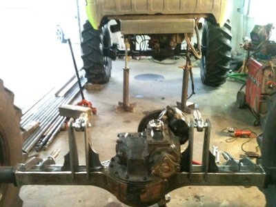

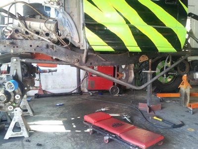

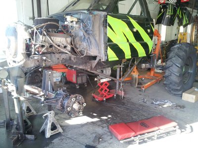

Update
Well, it's been way to long since we updated this thread so I thought I would take a second and try to catch everyone up. I really wanted t oupdate it every couple three days but it's difficult to take the time to come in and sit on my *** to post pictures when theres things to get done. I am not going to write on each of these post, I will just throw some pitures up of the progress and go from there!
