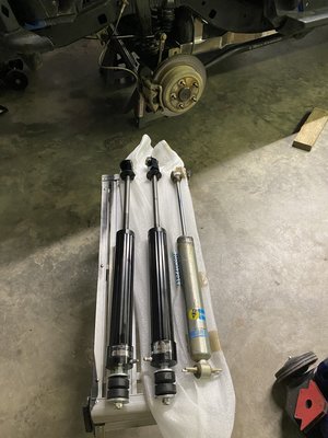

New shocks RRK 2.25 finally came in. I was able to get the back one’s on tonight.
D Dewitt10jku Aug 30, 2022 #1 Aug 30, 2022 #1 New shocks RRK 2.25 finally came in. I was able to get the back one’s on tonight.
D Dewitt10jku Sep 17, 2022 #2 Sep 17, 2022 #2 I took my rear 1310 driveshaft off. It was still hitting gas tank skid at full flex on rear passenger side. Changing from flange to yoke. Perry at Carolina drive line said this should help.
