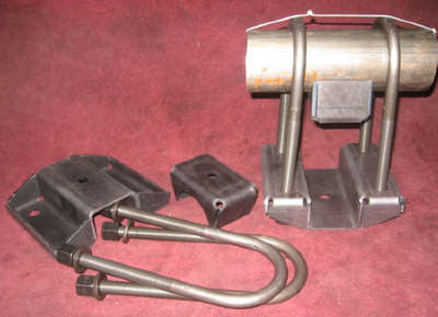

If he wants to put leaves in the back of his jeep let him do it. Its his jeep not anyone elses. I helped build some high clearance u-bolt plates for a buddy's YJ and it has the same ground clearance as the stock lower control arm mounts on a tj.
these are similar to the ubolt plates we made.

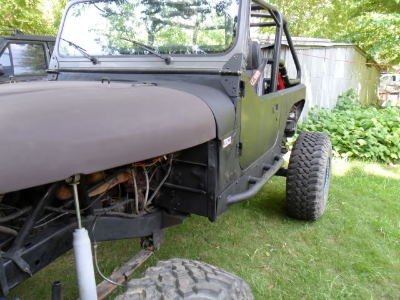

I've actually thought about doing leaf springs in the rear of mine but decided to go link for several reasons. One is that a link setup is infinately adjustable with ride hide and quality when coilovers are used. I'm a huge fan of leaf springs and have experienced first hand their awesome benifits. One being stability. A SOA is far better than a SUA. The only problem I've had with a SOA is axle wrap. Flex was always awesome though. I won't tell you not to do it because I'm all about taking a different route and finding what works best for me rather than the 99% of the wheeling world, so make your own decision on that.
Here's an example of a leafed rear TJ...
And here's the rest of the build from Pirate.
