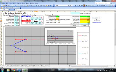

I've been messing with the 4-link calculator for awhile and finally got the damn thing to work on my computer. I've been reading a couple threads on pirate to figure some ish out and see what i can come up with, but honestly, at the end of the day, i'm going to try and make it fit and look as what i've seen in the past. I just ordered 6 - 3/4 heims misaligned to 9/16 to match the 9/16 bolts im using in the lowers from ruff stuff. Im home for a couple days because im getting my wisdom teeth out tomorrow so i'll have a couple days out of commission and become a wiz on interweb 4links, It will also give me a chance to take some numbers from my Jeep.
What numbers should i shoot for on the calc for:
Anti-squat:
Roll-center:
Roll-center angle:
any others im missing?
I'm looking for about 20" at the frame and running a 12" shock with 4 or 5 up in the front, and 6 up in the rear hopefully. Need to order my ford shock towers for front and rear.

Been playing with this Calc for a little while and i think i'm getting close to what i want. Take a look and see what you think. 4link revised oct21.jpg
Just incase that doesnt upload big enough look here
antisquat: 79%
Roll center height: 29in
Roll center Angle: 2
#32
your uppers on the axle will probably be in front of your axle centerline. Not sure if that changes anything.
and where did you get your CG hight?
#33
Oops i just fiddled with it some more and changed the CG to 32" and axle centerline to 2" and it changed my Anti squat to 90%.
I was looking at a few builds on JF and saw gtxracer and hendrix posted their numbers and i tried to relate mine to that. Im going to lower the jeep down to 20" to frame sometime and try and measure the top of the bellhousing from there as i'm told thats the best place to figure for COG.
