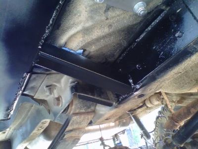

I made an effort to take photos of this project and will try to explain step by step what I did and how I did it. My goal was to add protection to the vulnerable are under the doors on the XJ while still being able to use the doors. I went a little more in depth than just a rocker replacement with mine. I also tied the rocker into the cage in several places. Take note that the rocker replacement will be a lot more solid if you already have a frame stiffener kit (or a home-brewed equivilent) on the unibody frame already for welding braces to.

Brace placement: cut to fit and stick it up there. With the hole already cut through the floor you should be able to weld all four sides of the brace to the 2x6 and the other end to the frame. I did 3 braces per side.
