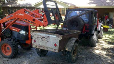

We have a 40+ year old John Deere 2wd that has been used and abused for years but gets the job done. It mainly gets used for small food plots and bush hogging our yards these days. I don't remember the model, but it's a decent size, bigger than the Kubota I posted.
In a previous job I ran some bigger tractor (ford 6610 and John Deere 6000 something). Those things are awesome, but would be too much for anything I need.
