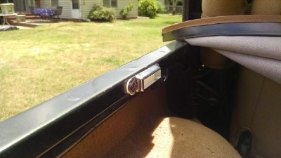

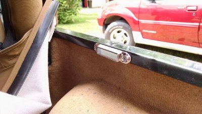

Mounted the brackets directly to the tub with stainless hardware. Eyeballed where i thought it should mount.
One advantage to mounting them this way is they shouldn't interfere with the hardtop and can stay on.
Measured and repeated on the other side.

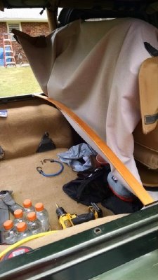

Cut the bow to ~ 57 inches, Tested, Recut at 55.5 inches for final fit.

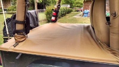

Finished shot. I might go back and add a second bow, but this should keep the water from pooling and the top from sagging when warm.
