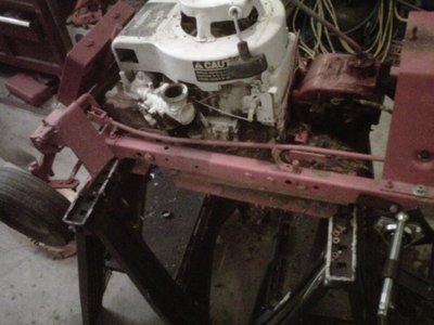

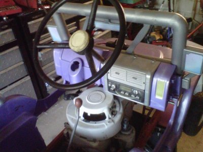

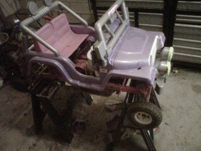

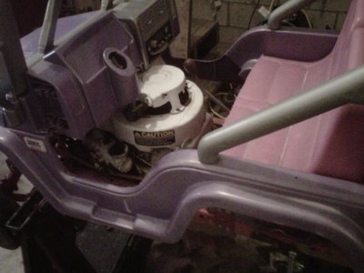

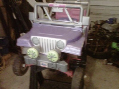

i have seen power wheels jeeps turned into go-karts before, but me and my son  wanted to make one that would go fast and have alot of power.  we used my boys huffy lawn mower that he rides around the yard, stripped it down and added a live rear axle with a taller gear ratio and disk brakes. has a 8 horse briggs with a 3 speed trans, its still in mock-up, so no paint or tires yet.
