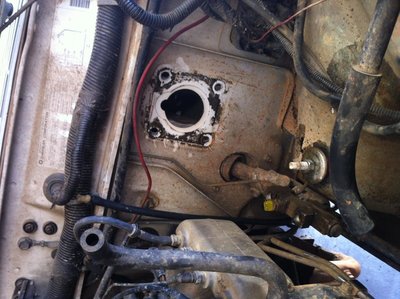

Pulled the master cylinder and brake booster off to start the install

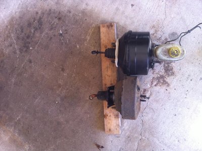

With the brake boosters set side by side you can see the difference in width

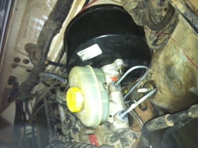

Once the booster and master cylinder was installed I realized I was gonna have to make new bake lines from the master cylinder to the proportional valve. I headed to the parts store and got 40" of 3/16 brake line and a few different fittings. The master cylinder I put on required a bubble flare and the proportional valve required a standard double flare. I made up the new lines and then tightened everything down. I bled the master cylinder and then bled each wheel.
