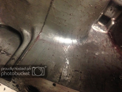

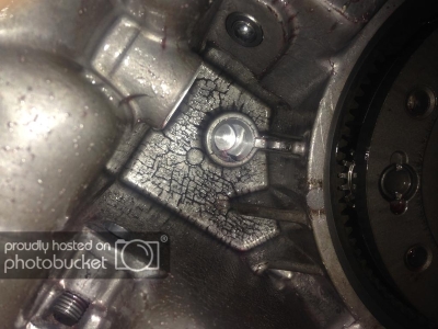

One issue I have is I bought the 231 with the SYE already and do not know what brand it is or if a seal for the SYE output is the same as the stock tailcone seal. Guess I will find out when the kit comes. Also the bolt on the SYE that looks like a fill plug (I never removed it except to try to reseal it) leaks so I have to find an o ring or something for that. There was slight scaring from the chain slapping the case but nothing to serious. I do have a question about all these small cracks that you can see in the pictures below. Is this anything to worry about or is this normal? Is my case about to spider crack everywhere and explode next time it takes a big shock load, or is this imperfection in the casting?
