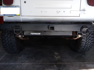

I did not realize this skid plate was just a plate to go under the factory skid. Since it was ridiculous to try and utilize my old skid plate, i needed to modify the Tomken. The Tomken skid was a pretty good deal compared to buying a new factory skid. It took about 1.5 hours fab time.
I put the factory plate inside of the Tomken to mark where i needed to add some brackets.
Pretty much i recreated the factory brackets and put them on the Tomken skid.
Gave it a paintjob and put the dirty tank in it. Such a shame
Strapped down the tank to the skid.
Now it is ready for installation. I ordered a new fuel filler hose, but realized the filler vent tube was rotted good. I ordered the replacement Vent hose and I am going to replace the rubber fuel lines. When i dropped the tank i noticed the lines were severely kinked when the tank was bolted back up before. Maybe that is why i was so sluggish, the fuel was pretty restricted to the fuel rail.
