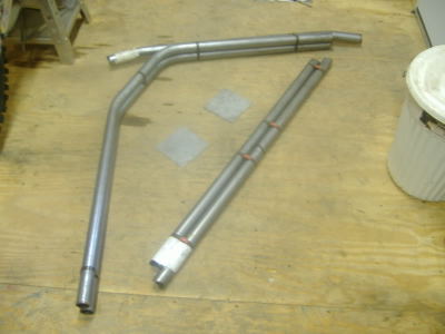

I bought a Front cage kit from SWRacing for 199.95 plus tax.

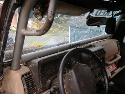

Here are some pics of it installed in other jeeps. This is a basic cage with plenty of room for additions.

It is 1.75 .120 wall DOM tubing prebent and fishmouthed.

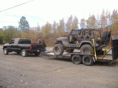

and this pic is after a rollover at 60mph on the interstate.
