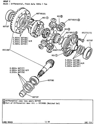

Pulling from memory, I don't remember these two threaded cap bearing cap like things.
Here is an exploded diagram. Looks like it has shims between the carrier and the bearing. I guess that is the "adjustment" part.
