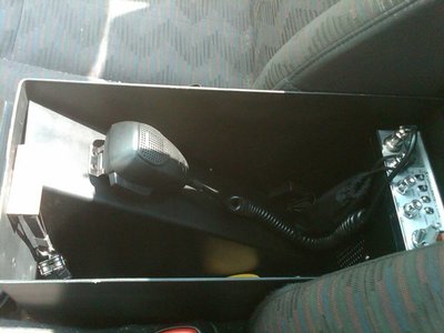

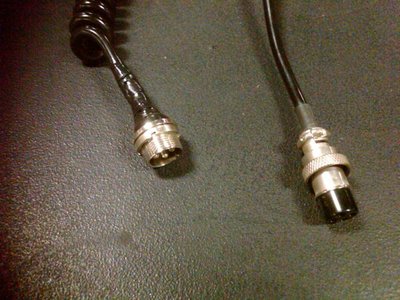

I have a DIY vaulted center console. The 28LTD is mounted in the console, the mic wire is extended to a quick connect through the console at the base, and my external speaker plug is wired to the audio input on my head unit. I set the channel, close the console, plug in the mic, set the stereo to auxiliary, and wheel on!
