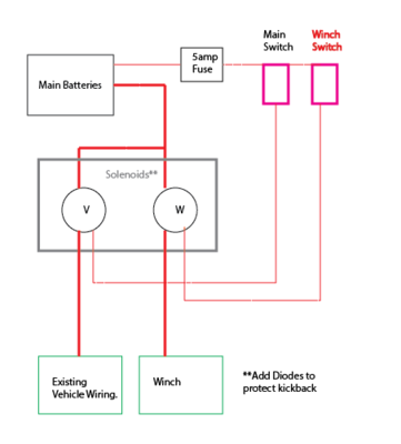

Rather than a disconnect switch, you could use a Solenoid and have a kill switch (standard size toggles) setup that would disconnect the power from the battery. You could use one for vehicle equipment and one for winch. the only downside is they draw alot of current to keep the contacts pulled in (1amp each). Worst Case on the winch solenoid is that the contacts weld and you have to tap it with a hammer to free them, but i highly doubt that would ever happen.

I don't think those relays would handle winch loads for long, if at all, and it really wouldt change anything with the main wire runs I'd need. A big, easy to reach, manual switch mounted to the cage between my seats will be fine for that portion.
I don't agree. A winch uses much smaller contactors/solenoids. You wouldn't be switching the disconnect coil under load, As long as the contacts are in good shape (contact resistance less than .5 ohm) you would never see any problems with a large solenoid such as the one I sent earlier. This also applies to your vehicle starter solenoid, they too are much smaller than the one i previously sent. I have seen this type used as starter solenoids on Semi before...

A winch uses a series of solenoids to handle the load, not a single solenoid. Starter solenoids are momentary and certainly pull nothing like what a winch will do under load.
At the end of the day, that's just adding more moving parts and that's not my aim here. I'll take a 300 amp rated manual switch over a 200 amp rated solenoid. I don't trust the 300 amp switch to be capable of handling the winch load either.

The winch actually only uses solenoids to reverse the polarity to the motor to spin both directions. All of the current still flows through a single solenoid. That said I wouldn't add solenoids to do what you want. I would wire it up so that the battery disconnect kills everything but the winch. I think you are just out of luck of putting that on the switch. I would let it kill the alternator, computer, fuel pump. Everything. It isn't a shutdown for the vehicle except when **** hits the fan or you store it. No reason to worry about the ecu memory. Relearn is fast and doesn't hurt anything.
