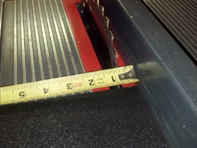

I first cut a piece of plastic sheet to ~ .75 x 23.25. Table saw makes this super slick.

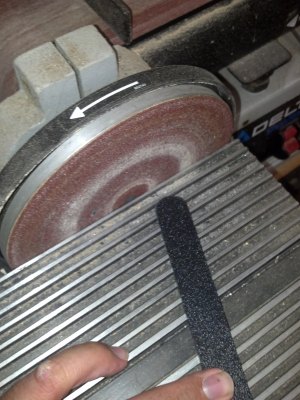

The notch in the hard top is rounded in the ends so i took the plastic over to the Belt sander to radius it.

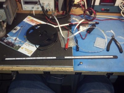

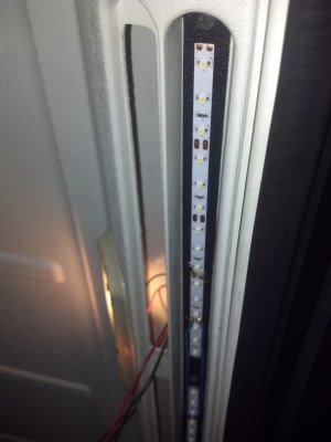

Then I cut two pieces of the LED Strip 5 Segments long and attached them to the ABS. I left room in the middle and the ends for a mounting screw to go.
Soldered up the two strips and added a pigtail to do the interfacing with the jeep wiring. Also did a quick test to see what the current draw was on this strip. Measured ~.28 Amps @ 13.81vdc.
Back to the jeep i go. As im mounting this strip, using half inch self taping screws, it dawns on me that it would me nice to have control of this led separately but also have it operate in tandem with the dome lights. After mounting and testing the light output i do some quick goggling for a wiring diagram for the hard top.. Man i would be nice to have a constant 12v feed in that plug, turns out there was. Pin 8 Pink/White.

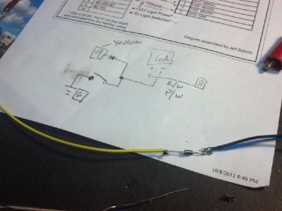

After some quick Thinking. I decide i want to put a override in the back of the jeep to power just this LED on but still have it operate with the domes this is what i came up with.

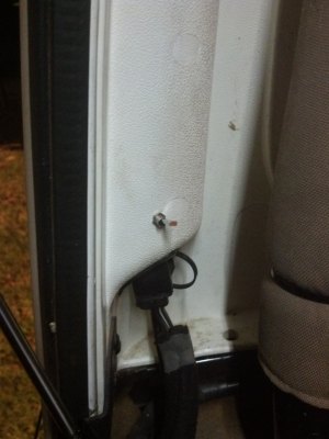

It uses a 1N4001 or 1N4007 diode to isolate the grounds to keep all the dome lights from being activated when the rear toggle is switched on. You can see the "harness" I built, I heat shrinked it and fished it through the hardtop. Final Product.

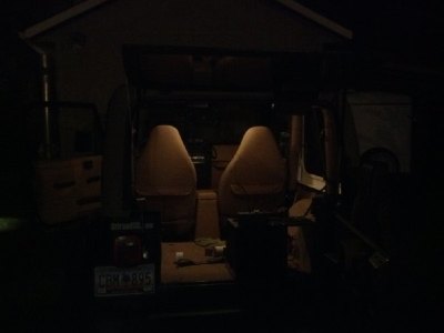

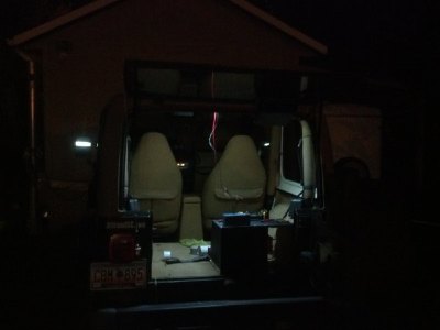

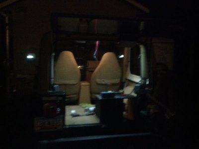

Couple shot with various combinations of lighting.
Dome and LED
Dome
LED
