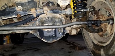

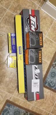

Update - Going to start out beefing up the driveline, hopefully before Uwharrie. Just order the front axle shafts, new Timken unit bearings and the ZJ steering upgrade to boot.
After talking to Larry some more and really looking at his set up - just the suspension, not the excellent engine swap - I'm going to try out the low COG set up like his. His obviously works well and as a side benefit I'll have less cost in it for now. If I really want to I can add springs, driveshaft, etc later.

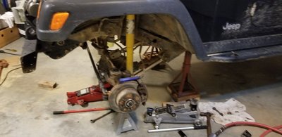

#14
Front end completed. We'll see how much I get done tonight. Looks like I gained more than the 3/4". I think it is because the longer lowers put the springs in a more vertical position. Regardless, I like it!
Even though it has a mini sissy squat, I took a test drive. It handles just like before up to 65 or so. On to the rear....

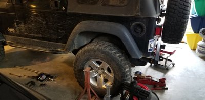

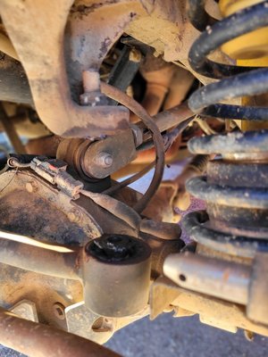

#19

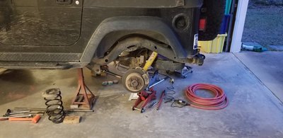

Got all the arms installed. Found where one shock had been hitting the coil bucket and clearanced it. Then I found that the other shock was going to be hitting its coil bucket, so I clearanced it. And serviced up the parking brake cable, etc.
I have her sitting back on all 4 wheels. The pinion angle is off, but everything else looks good. Getting that squared away is tomorrow's task.
#20

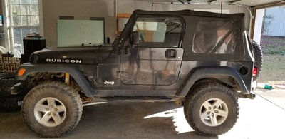

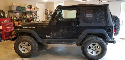

Done. No vibes up to 70ish. I'm happy with how it turned out. Looking at the picture, the rear axle is more centered than it looks here. I'll post a better picture tomorrow.
