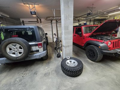

So... I bought a hard top. It came with a jeep.
There's a few problems with this one. Cylinder 5 misfire, 330k miles, and the steering wheel is on the wrong side.
I'll do some quick diagnosis to see if its something simple or if it ate the cams on #5, but now I have a conundrum. Do I swap soft top on it and sell, or keep for all the other random parts I might need one day and possibly an engine core?

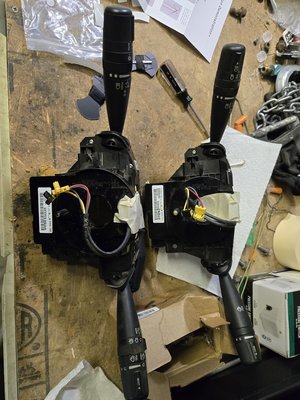

I started the process of transferring over hardtop conversion parts last night. I pulled the clock springs and stalks off both jeeps and swapped the stalk with hardtop wiper and rear sprayer controls over. The red one had an airbag code so I'm going to try the clock spring from the mail jeep and see if it goes away.
