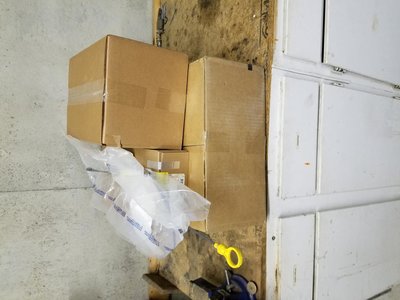

    Go ahead and scheduke a couple days in Leesville around Christmas :). Taylor too!
    Getting excited:

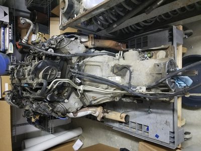

    Dave's custom unlimited motor mounts ordered. I was trying to hold out for another 20% off sale, or more, but with the looming tariffs and other companies raising their prices, I decided to buy at 15% off. It basically equaled free shipping.
    I was also going to order an ECU mount, oil level sensor plug, and a vacuum nipple he sells, but I found an ECU mount and plug I like better for less. I looked at the brake booster vacuum line that they sell the nipple for and my motor has the complete line with check valve that will plug right in the jeep booster. Small win!

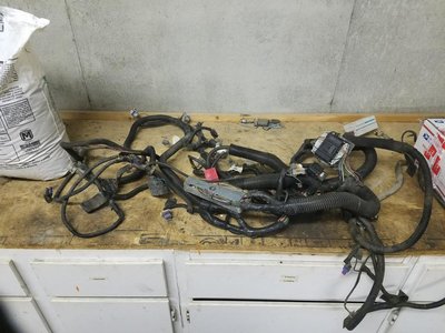

    I contacted Charles Friday and he gave me a contact in Greenville for the harness work.

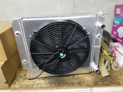

    Probably going to order the radiator in the next couple weeks, and oil pan whenever I can get by the dealer during business hours.
