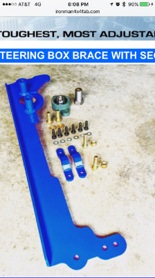

I'm partial but Ironman4x4fab in NC makes some awesome steering stuff. Cross braces and trackbar tie in stuff. If I were to build a street-able wheel-able xj I'd have long arms and properly tuned shocks and shackle relocation boxes on the rear.
#23
Just looked at their site. Parts look really well made and super strong. Thanks for the heads up
#25
Yea Andy is a great guy and his biggest problem is you only order from him once..... they last and the they a beating and he will stand behind anything you buy.
#26
I'm liking this
