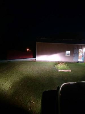

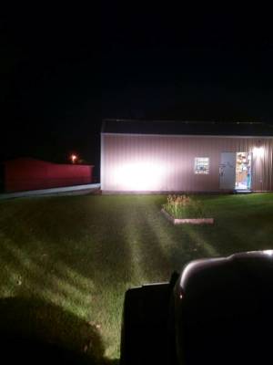

Low beam
High Beams
I feel like crap so I didn't get technical. I highly recommend these housings and the 80/100 watt bulbs.
Sent from my XT1585 using Tapatalk
