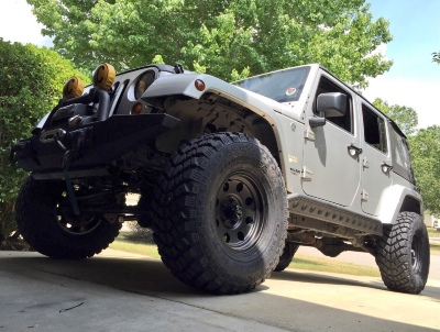

Me personally, I did a 3.5" Rough Country suspension lift. Came with all you need. Springs are the same tension as stock, so ride is about the same. Plenty for 35". Believe it or not, that extra inch will make a difference with articulation. bd1315b1a6db7c7adb3867061b2e7edb.jpg
#8
I thought for anything over 2.5" you need to replace the drive shafts. Is that not the case?
I did not. Still the stock shaft. There is the *possibility* that you may get some rubbing under fairly extreme conditions. The rubbing comes from the shaft on the skid plate. There are thinner after market shafts that are purchasable as well. However, while I'm not out doing very extreme stretching of it (still a DD) I have had it on the obstacles, swaybar disengaged with no problem. It's certainly worth watching but unless you're going to be going crazy, it'd probably be ok.
