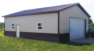

For the area you are looking in, I doubt you are considering a pole barn or metal building though. I have seen the fronts get bricked up on a pole barn and look really nice. Or do a accent color along the bottom...
I am about to add a section to mine for a hang out spot and a place for the car after Harlan. When I get that done I really want to change the door configuration on the big shop to the one small door and one really big door offset. Then do an accent color along the front lower sections to make it look better. In time, that will all take place.

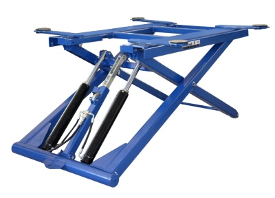

Anyone ever used a lift like this? I know it's not as nice as a 2 post but would take up less space and still be useable.

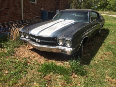

My father in law has been telling me for years he had a 1970 chevelle that was sitting at someone's house who was suppose to be working on it. 7 years later and the guy hasn't touched it and it's sat in the same spot where he dropped it off, so he's wanting me to get it and clean it up and do a few things to get it back to its glory. That's another reason I'd prefer to walk into something already built.

I’ve looked at lifts like that a few times but the thing that holds me back is there will be a lot of parts under an automobile that will be blocked and obstructed by the lift itself.
#17
Miller had one of those lifts for sale a few years ago. I considered it but decided against. It would be good for wheels/tires/brakes/axles, but anything underneath it would be in the way.
Ideally, I would love to have both a 4 post and a 2 post. I don't like working under 2 post lifts but 4 post doesn't help you with suspension work. I have pretty open access to a 4 post, but a 2 post would be handy at times.
