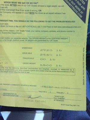

The reason I want to go a little bigger than an 8k winch is weight. I went and had the truck weighed. With the spare, two people inside, a full tank of fuel and a bag of tools it weighed 5500 lbs. the truck itself would be around 5100lbs. IMG_6737.JPG
