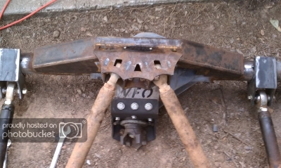

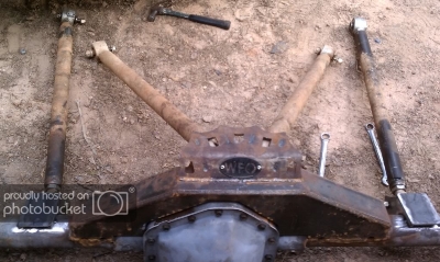

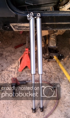

Well the rear 16 spline 60 finally let go a couple weeks ago during a good ol tug-o-war. needless to say its about time i have an excuse to tear it all apart again and install the 14bolt. I sourced a 78 single rear wheel 14 bolt from pull-a-part and installed a set of yukon 5.38 r&p, and yukon grizzly locker, and disc brakes from my 60. I added a WFO truss to the axle with the pinion guard. Also ditched the coils and shocks for a set of Fox 2.0 16" airshocks. Im also reworking the rear 4 link in hopes of some better numbers. Enough bore here are some recent pics.
airshocks
wfo truss/lower control arm mounts and bump pads
14 bolt/links
so currently the jeep is on jack stands with the lowers bolted in and we are currently workin on adjusting the upper frame mounts as well as the geometry of the rear suspension. i have mixed feelings about the airshocks but im going to give them a shot cause i found a deal to good to pass up. hopefully the jeep will be back to working order by next weekend.

It now has coilovers in the rear instead of the airshocks (go figure) and the rear suspension was re-done, again. Front is now a three-link w/trac bar. More stable than before, anti-squat is still alittle high though. Its also stretched alot more. Comp cut is well used now. Its alot more drivable. He just needs to ditch the LTB's for a set of 40 kevlars or KM2's. Then he wont have a reason to not wheel it.

The air shocks had nothing to do with the bad behavior from the rear chad just had money burning in his pocket and had to have the coil overs(which were only slightly better). It was purely the **** suspension geometry that was there from when brad built it. The air shocks just didn't fight it any. The anti squat was outrageous something like 140% if I remember right, it also had around 8* of oversteer. Putting in the 14 bolt made it worse since there was way more vertical separation at the axle side.
#32
Havent updated this in forever. A lot has changed since the last time. I got the 14b in the rear and it now sits on some 14" Fox coil overs. 14b is stuffed with a yukon grizzly and 5.38s to match the front. Clippa reworked the rear suspension a little bit to help some with the bad anti squat but it cant really get much better with the huge wfo truss thats on it now. i plan to grab an artec here pretty soon to get better geometry. Clippa also converted the front to a 3-link with panhard. with the new suspension the jeep rides better than ever. steering feels solid and the only complaint is that the rear springs are too stiff. currently running 150/200 and plan to rework the upper shock towers for more up travel and go with 150/175 springs. i recently got a box of yukon goodies from complete off road. got some 4340 35 spline outers, new pinion install kit, forged yoke, new u-joint strap kit, and the chromo hardcore locking hubs. i have the axle torn down now and have taken the old stubs off and installed the new ones. gotta take the pinion up to parts plus to get the bearings pressed off and new ones pressed on. then just reassembly is left.
