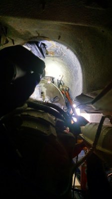

Pulled the Trans Last Night / Today .. Side bar -Whatever Stupid *** engineer decided it was a good idea to use that Reverse torx bit on the top two bolts should be stoned to death with them. I ended up rounding off the passenger side bolt (but not apparently before breaking it loose, it came out by had after i had the trans down) and had to cut the head off. Pulled the trans and clutch down, Clutch actually looks good. Trans makes all sorts of nasty noises when you spin it by hand, as well as has some funky looking oil in it. Looks like muddy water mixed with an oil spill. So now to my question.
Cheapest Price/place on a Remanufactured AX15 with Warranty .... Go...
Im not gonna risk rebuilding mine for it to grenade on me next month...
