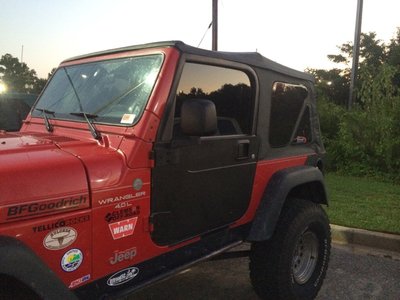

#12
This is after 2 years of scraping them on trees. Instead of flaking off, it did wear through to the old flare color in one area on the back flare from rubbing it on a bank at Windrock.
