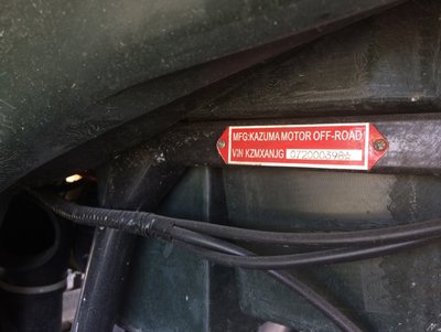

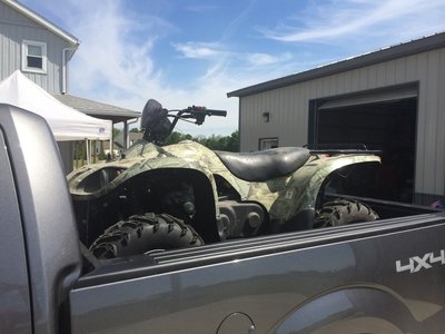

    My brother got a huge deal on a new four wheeler a couple years ago. It has less than a mile on it. It's one of those Chinese brands. The story is that the dealership found it with a dead battery one day and someone tried to jump start it the incorrect way. Frying electronic components. They just sold it as is for next to nothing because they didn't want to deal with it. My brother got it and replaced the computer but no luck. I am bringing it back to sc to take a shot at it. Let me know if anyone here has any experience with these or any contacts that may help.
    Here are a few pics. I'll post more info when I get it home.

    If its the one im thinking it is then it is essentially a Yamaha grizzly 660... do some Google searches I think the parts are interchangeable
