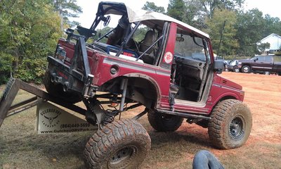

OSCAR 2 was rough on the Sami. It worked great, but had some issues this trip.

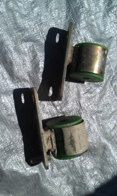

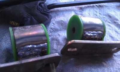

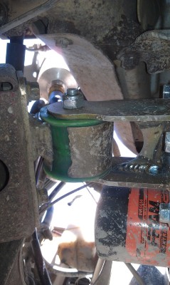

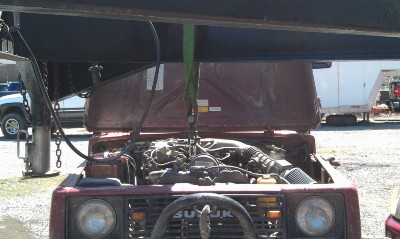

Broke both motor mounts on whitetail.
trip to Larry's ATV Welding.
Gooseneck for engine hoist
I noticed the engine mounts when I was underneath it because my rear driveshaft was about to fall out. I also broke my winch cable on Upper Rock Garden, bent the right side at the door hinges and had to beat the door back on, and bent the left side on whitetail.
Good news is it made me go ahead and get synthetic rope, so I'll be working on that this week.
I just sent an email off to the company that makes the engine mounts and we'll see how that goes...

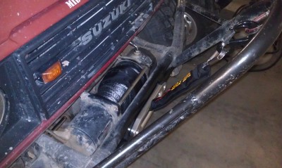

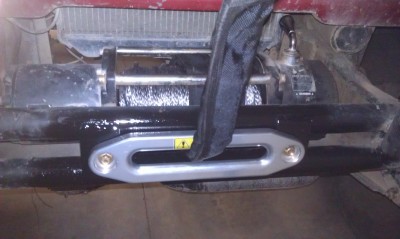

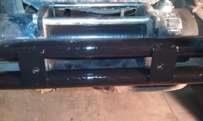

I finally got around to putting the synthetic rope on the winch.

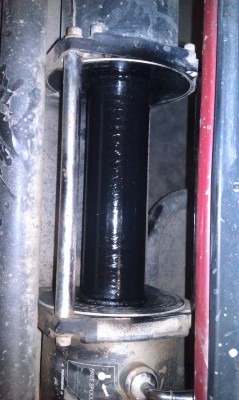

Cleaned up, sanded, and painted the drum:
Cut out the old solid stock I was using for a fairlead and welded in plates to mount the hause fairlead too:
I'm still rocking the patched motor mounts from Harlan. I got the run around from the company I ordered them from and the company that made them. I'm going to try again but it's looking like I might have to buy or build some stronger ones.

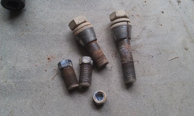

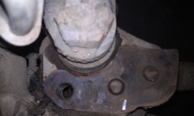

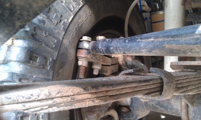

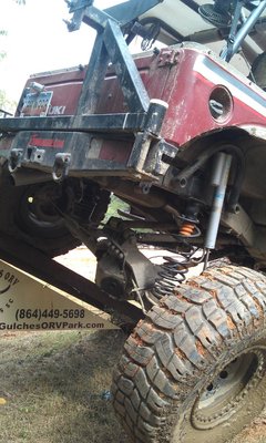

At Gulches yesterday, I broke 2 of the 3 high steer arm bolts .
I got really lucky and was able to weld nuts to what was left and get the bolts out. Now I just need to get another conical washer and some bolts, and lots of locktite.

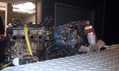

So, I picked up a few spare parts tonight:
They both run, but one knocks and one won't hold timing. For the price I couldn't pass them up for parts or for a core if anything happens to mine.
Now the only drivetrain parts I don't have spares of are ring and pinions and short side rear shaft. I made a deal with a guy for another set of rear shafts, but I have to get to Greensboro at some point to get them.

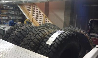

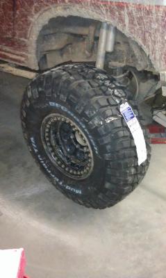

#60
One down... I forgot how much that sucked. Any tips on breaking the back bead? I had to resort to the hi-lift under the back bumper of the truck to break the bead. Also, I didn't get this one centered perfectly...
