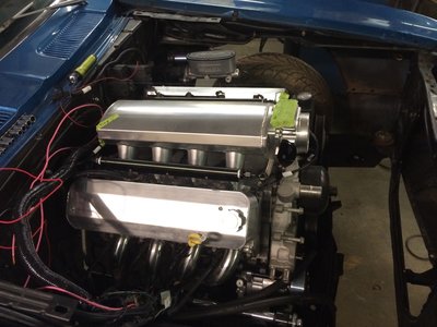

-Clutch/Brake master cylinders/hydroboost was all hooked up last night (not lines). Fitment seems right but may have some adjusting to do later on. Hopefully not.

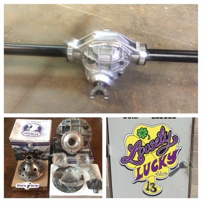

-Rear end is built. Waiting on shafts to get here so we can cut down the axle tubes and weld everything up. Should have it bolted in next week.
Things left now are wiring, lines for steering and brakes, exhaust, driveshaft, and some adjusting on front suspension. Feeling like I'm finally on the home stretch.

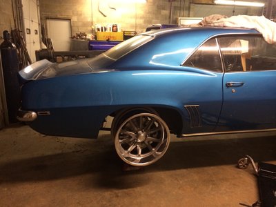

Wheels....they have changed since the pic I posted. I am ordering them next week. Will post a pic when I get them in. More of the pro-touring style.

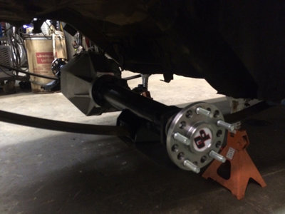

Short list is getting shorter. Rear end gave us a fit. A lot of parts that didn't work the first time made it take much longer than it should have. But, it is now in the car.

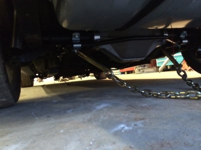

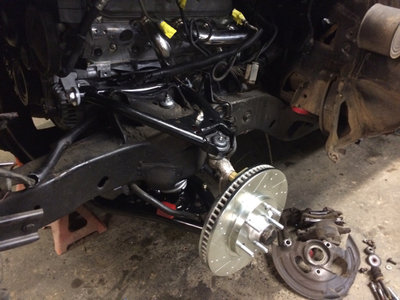

Car should handle much better this go round. Has rear sway bar now and an upgraded front sway bar. Coil overs up front and tune able shocks on rear. Will have a anti wrap bar on rear soon. All tubular a-arms up front.

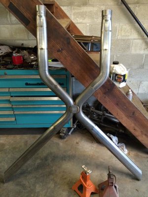

Welding up exhaust is a lot of fun to tig. good practice if your trying to learn.
