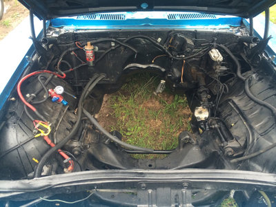

Out with the old
In with the new. To be continued...
Got more than expected done yesterday. Everything is ready to come out of the TA next week. Will get everything out/cleaned/painted/built next weekend and hopefully start mock up.

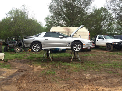

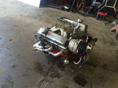

So it got a little slow the past two weeks thanks to OSCAR and hay season gearing up.

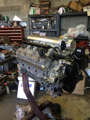

The week before OSCAR we got the LS1 and T56 pulled from the T/A and everything cleaned up real nice. Got the motor on the stand ready for the new goodies. We will build the motor this week and hopefully get it set in the car for at least mocking up where things need to go.
Big things left to purchase:
New wheels/tires
All rear end parts (plans are for a custom built alum 9" rear)
Fuel system
Already over budget... but I went a little further with the motor build than I had planned. I think it's worth it in the end. I went all out on Ram-Rod and it paid off. Not that I intend to sell the car, but if you do it right the first time you don't have to do it twice.

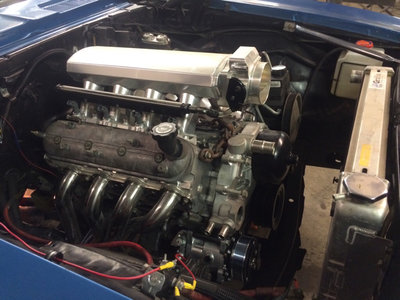

Engine and Trans are in. Cross member, motor mounts, and A/C bracket to keep it mounted low. A lot of time in the setup but the fitment is worth the time invested.
#34
That intake looks hella good. You keeping a/c in it?
All the lsx motors I put in cars I usually always spent good amount of time getting them in and as low as I could so there would be no issues with clearance and plumbing and setting them as far back as I could too. Should handle better too.
#35
Yea. Definitely keeping a/c. Motor will actually sit back 1/4" from where it is now. The ls engine seems a bit shorter than a sbc. Lots of room to work with. To mount the a/c low and not notch the cross member it doesn't sit as far back as it could but were gonna scale it out and make sure were still good there. I think it will actually be about a half inch to an inch back of the sbc mounting position. At least in the front.

That seems about right from doing no measurements. I am right at stock location currently which allows me to clear the cross member with the low mounted A/C which is the only way to go IMO. They look like hell the way most people kick them off to the side for clearance. I will actually end up a touch back from stock location when we push it back next week. We are going to put it on the scales and get it to what works best for the car as we built in some movement to the mounts.
