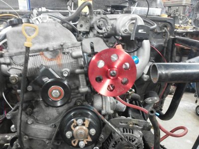

Some new bling under the hood..
A little hint at whats under the hood..

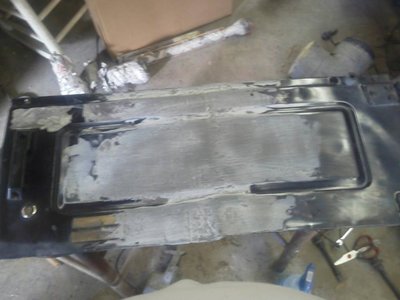

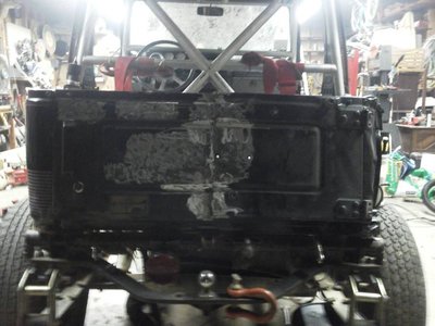

Also cut my tailgate down since I dovetailed the rear. It still swings open and functions as it did before. Cut 11" out of the middle
A little bondo and it will look good as new. If you really wanna test your patience come weld on some sami sheet metal. Ive drank beer outta cans thicker than this crap. You could literally burn through it with a soldering gun I think.. Spot...spot...damnit... spot.. spot.. mutha fucker is pretty much how it goes...

.024 and they heat all the way down.. I eneded up having to back it with a strip brass to absorb the heat and that helped out a lot. Its still no fun though...
#45
when we cut out for Larrys stretch on his sammy we found that out, I think beer cans may be thicker. Looks good though man, nice work. I'm ready to see of video of this thing getting it through the yard!

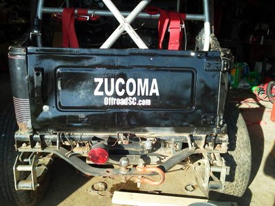

Tailgate is finished and the offroadSC swag is on! The tailgate has never been straight as the sun had been hit from behind before I ever bought it. But it serves its purpose for keeping stuff from falling out the back.

This being the first motor ive ever torn completely down and rebuilt myself it was very nice to hear her fire off... I was worried that I hadn't got the timing set right considering thatmotor has 3 timing chains...

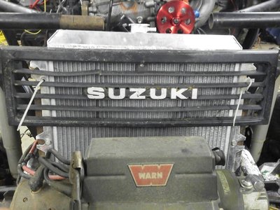

Got the radiator mounted tonight, just gotta finish weld the mounts. Also got the orbital mounted and ready to go. It seems all these little jobs are the damn hardest to commit to and finish...:sly:

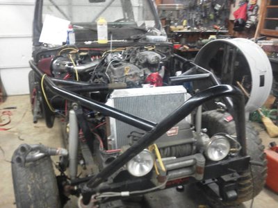

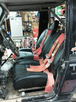

Got some small stuff done in the past few nights...
Mounted the seats
Whats left to do....
Fix clutch
bend trans shifter
Drive shafts
mount 40's and check for clearance
mount steering ram
Top off fluids
Im in the final stretch, just gotta get done!
