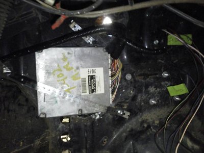

Ecu mounted in the passenger compartment to the firewall. Strap is just holding it down so it doesn't flap.

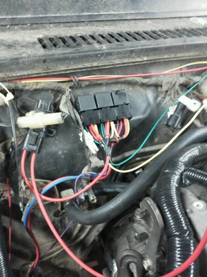

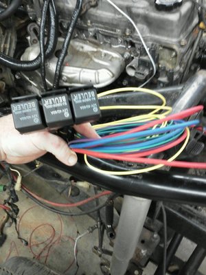

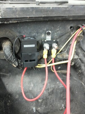

The Taurus fan wiring is a monster.. finally got it figured out. Its got a temp sensor that turns the fan on low at 182 degrees. Then at 195 I get a warning light on the dash and I have a toggle that will ground out and turn it to high. I could have added amother temp switch fir this but I had to cut some cost somewhere. Those things are not cheap! This bitch draws 45 continuous amps... thats alot for an e-fan so I had to build the relay system to hold it. It takes up alot of space.. but I shouldn't have to worry about it now!

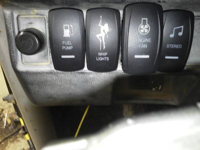

Also wired up my efi relay. It has a safety cutoff toggle in the cab in the cab.
Here are the switches. I got a smoking deal on them at $5 ea. Apparently the website had a glitch and i took advantage of it. Tried to go back later and order some more when I realized it but it had been fixed. The zuk had factory knock outs on the dash that fit them perfectly. They turned out slick.

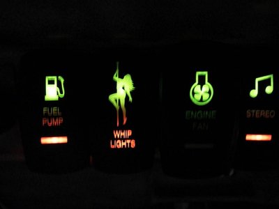

Lit up in the dark.

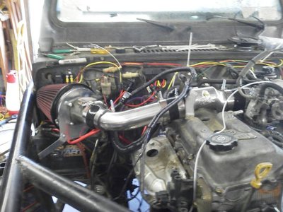

Got the intake on today. Its the trail gear one for a Tacoma and the filter is fawking huge... had to modify a good bit of it to make it work.
Also filled the motor with oil and turned it over several times to prime the oil pump..
I then hooked up the fuel pump and checked the system for leaks. Then turned it off. I knew the tank had some water in it so I drained the fuel rail and hooked the pump up to pump all the bad gas/water out of the tank. There was less than a gallon in there. Hooked the fuel pump back up and put 5 gal of premium in. Hit the switch and wwwaaapppoooowww the fawkin $160 brand new warlbro pump burnt up.... it still spins but has absolutely no suction. Checked the pre filter and it was clear as well and blew air threw all the fuel lines and still nothing .. apparently they done like a watery gas mix... I have the worst dumb luck with this thing....:banghead:

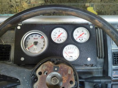

Did a little bit of work today. Got my gauge panel built and gauges mounted and wired up
