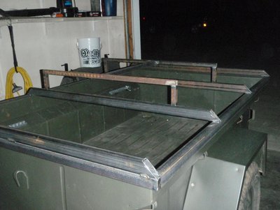

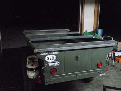

got the crossbars cut, going to weld them in tonight. waiting on my hinge parts and I need to stop at grainger monday for some desta-co latches

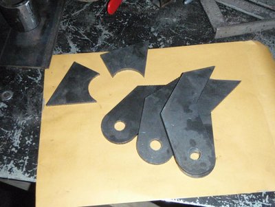

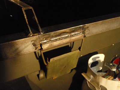

picked up some hinge parts I had plasma cut from Neill. If you need anything cut they can do it. I drew what I wanted up in CAD and sent it to him and he had it cut in a day. Thanks Neill!!

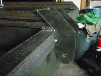

I got the hinge parts today expecting my bushings to be in, but they werent, There was an error in shipping at Ruff Stuff and they overnighted them to me, so I should be able to finish today. I wish I had some more time before this trip. There is just too much to do to finish it. I'm having to rush and I hate doing that.
here are some pics of the hinge.

very nice..
thats turning out very nicely. I like the hinges..

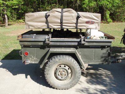

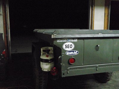

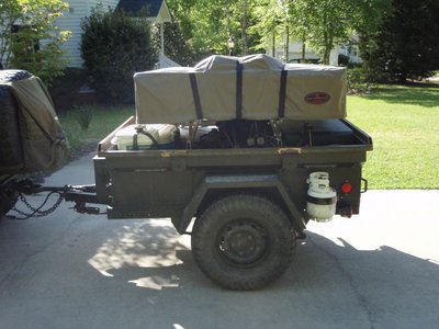

well, finished the trailer lid enough to bring it on the trip this weekend. The hinges and latches worked out great. Now I just need to skin it with aluminum, but that will be after the trip.
Camera battery died today, so I'm charging it and going to try to grab a few pics in the AM before work.
#56
The lid weighs about 65 lbs, so its not the lightest around, but I wanted to make sure it didnt fail bouncing around on rough roads with the RTT on top.
